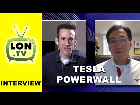

                  It is certain, they are using the same batteries that they put in their S models. If you have an half an hour to watch this video with Tesla VP Jim Chin. He tells you you exactly what inside the Powewall's. Same battery used in the S model with different controls to limit discharge and DOD rates to extend cycle life. He also states or admits Tesla 7 Kwh system will not be available because there is no way to integrate it into a Grid Tied System because state and federal regulations will not allow it to be used as intended for Peak Load shifting. Utilities and regulations will not allow a person to buy and store cheap Off-Peak power from the utility, then turn around and sell it at higher price Peak Hours for a profit. That would be stupid. What he admits is the market is utility scale and large commercial users using commercial sized systems. The consumer market is a Hoax.
                  What it all boils down to is hype on Musk part to get a False bump in stock price which has worked as of now. Great if you have Tesla stock and looking to sell a few shares.
                  Originally posted by bberry
                  400v isn't a good choice choice for residential retrofit, but that is not the market they are designing for. The unit likely needs to be closing tied to inverter control functions, so the powerwall isn't suitable for a straight battery replacement anyways.
                  That is explained in the video too. Tesla chose 400 volts because they use the same control equipment they use in their vehicles. They just adapted it to the smaller scale Powerwall. In other words they stuck with what they already have and know. Higher voltage has a lot of merits. But as you pointed out is not used in off grid applications. To make it work requires a DC-to-DC converter or another expensive egg in the basket until someone makes an Inverter to work with it which will be expensive.

                    Once again only about 10% of whats been posted was actually said in the Video.
                    Thats funny since the Fronius Hybrid Inverter is already being sold with their own battery that does exactly that and was never said in the video. In fact any hybrid Inverter will sell or can use Grid support.

                            Division manager Martin Hackl at Fronius said
                            The inverter that will be used is the Fronius Symo Hybrid, which also supports the Fronius Solar Battery already on the market.
                            This is Opinion and was never said.
                            Opinion
                            The Model S uses a 85 KW battery.
                            Any grid tied Hybrid has a bi directional input and will sell based on battery voltage, it doesn't care what time of day it is. you set the high and low voltage and let it sell.
                            Any grid tied Hybrid can have the ACin set low and the support amps set to support the loads. You set the ACin to 5 amps and the support to 4 amps and the inverter & battery up to it's capacity.
