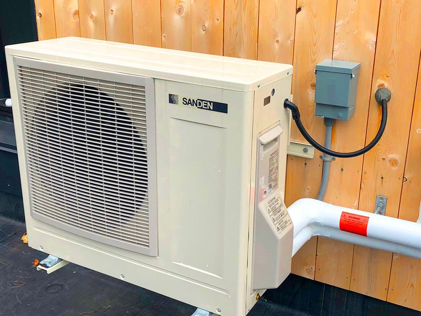

                      Yep. And in areas that it gets really cold there's always Sanden. They're expensive but work with a COP of >2 down to -20F.

                          I have a NYLE (built in Maine so they know cold) external HPWH and it is sad they left the home market. They used a different refrigerant that was a little more suitable for the colder climate. I have a couple of engineering studies on HPWH and just don't believe COP of much over 2. Refrigeration technology hasn't changed that much. It is all about the fine print and how far you want to stretch the truth.
                            Originally posted by PNPmacnab
                            .......... I have a couple of engineering studies on HPWH and just don't believe COP of much over 2. Refrigeration technology hasn't changed that much. It is all about the fine print and how far you want to stretch the truth.
                            No one questions that there is a temperature below which the heat pump portion of a HPWH wont work. If that is 30 days or 120 days out of the year that still leaves nine months or more days in which it can beat the pants off a resistive element. That is why a Hybrid like the Rheem or AO Smith can work in Northern climates..I agree a HPWH is no match for Natural Gas when available.
