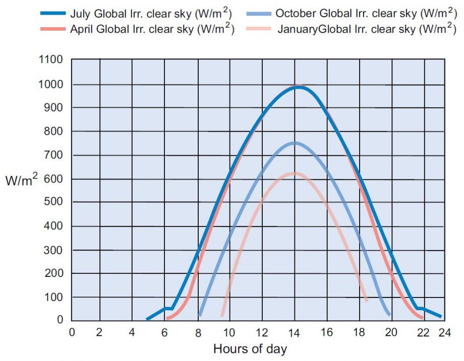

        I'm going to say that it's your SE azimuth if your azimuth were closer to 180 your panel would be harvesting more BTU's. I have the same issue with my 3 X 28 sq ft panels at 142 degrees my pump turns off at about 12:30 pm this time of year, May June and July 2:00-2:30.. Your limited to the production because of the angle the sun is hitting your panels and the height of the sun. In June when the sun is at it peak you will notice increased production. Here's a solar irradiance chart. I f you want more HW add another panel.

              One other comment. I think there's something amiss w/ Lucman's graph. It needs info about lat./long. and surface orientation. It can't be for global horizontal insulation and have a peak at ~ 1400 hrs. It also can't be for a surface at 142 deg. az. and some (??) surface tilt to the horizontal and show a peak in irradiance at ~ 1400 hrs.

                JPM it's just a general graph under optimum azimuth and tilt conditions, used it to illustrate the time of year performance differences. The true performance of the panel would need to be calculated using Solar Pathfinder or equivalent software with the actual panel model, GPM, azimuth, tilt , Longitude, Latitude and shading and or fouling.
                  Optimum tilt and azimuth conditions for who ? You ? the OP ? Anyone ? Without a bunch of qualifiers and caveats, that graph and presenting it here, and in that fashion, is misleading, particularly IMO, for someone like the OP who seems to not have the level of solar knowledge necessary to understand how misleading that graph is, particularly for his situation.
                  I appreciate what you write in the above post as to what's necessary to estimate or actually calculate solar device performance every bit as well as you do, and I agree.
                  My comment was made because to publish that graph in the way you have done has done nothing to clarify the situation for the OP, and maybe made it more confusing. Also, the way it was presented makes that presentation open to criticism as being inaccurate, confusing or simply wrong.
