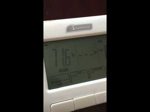

                    From today:
                    As for my wood framed box:
                    Soon I will need to concern myself with internal temps.
                    The outer surface of the wood is painted white, and clad with white steel trims.
                    The interior is painted with an acrylic flat black paint.
                    I had been thinking I might fab up a cover to minimize internal temps during the period of say, May to Septemer (Halifax, NS Canada).
                    • Craigwell
                      • 9
                      Also note I was holding my son, and he became fidgety by the time I reached 40 on the Anemometer LOL.
