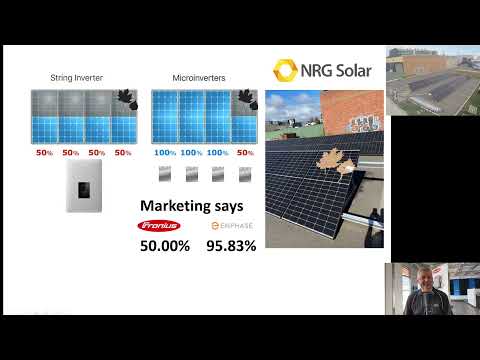

    Micro Inverter VS String Inverter (The Lie Verified)
    We all know the advantages and disadvantages of each kind of system but the one major Advantage of Micro Inverters has recently been proven to be untrue and just a marketing gimmick to try and justify the extra expense. (Luckily one company did the comparison in a scientific manor.)

    Thank you. I totally agree. I've known this ever since I split my array and ran half on a SolarEdge distributed inverter and half on the old Xantrex string inverter. Xantrex consistently did a little better.

                      I watched video with interest not because of string inverters vs microinverters debate but because of shading impact on panel production. It was snowing yesterday, around 9” of fluffy snow, and I decided to do experiment to see impact of some hard shading on individual panels production. I left a bit of snow on some panels. I have plenty (72) so some production loss for one day is immaterial. All panels are LG Neon2 330 and all microinverters are IQ7. Picture and panel production readings were taken at 12PM. It was rather cold so the amount of the snow in the pictures did not change.
                      You can see that even very small amount of snow covering panels greatly affected electricity production.
