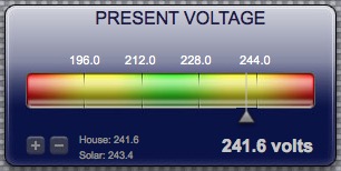

      If that is in fact how TED measures the voltage, then it is invalid. While in theory the halves should be equal in practice they are not.
      Looks like it was a settings thing, and I just changed the "Display Voltage" from 120V to 240V.
      Interesting thing is that it matches what the SolarEdge online portal shows almost exactly. SolarEdge shows 243.86V and TED shows 243.4V.
      EDIT: And here's another thing. The TED has 3 wires, black, white and red, and in the installation instructions it say stop use the black and white, and cap off the red. But now looking at the settings, it can be set to 120V (WHT/BLK), 240V (WHT/BLK) or 120V/240V (WHT/BLK/RED). So perhaps I should connect that red wire to a breaker on the opposite phase?
        Originally posted by HX_Guy
        BTW the SolarEdge inverter is reporting an AC voltage of 245.16V while the TED5000, which is inside the main service panel, is showing 121.3V (242.6?). So that's about a 1.1% loss? The run is only about 15 ft, is that normal?
        Maybe, maybe not but sounds real good. The loss is a product of current flowing through resistance. So it depends on how much current is flowing, and the size and distance of the wiring.
        This goes back to what I said earlier about measuring with a micrometer, mark it with chalk, cut with an ax, a make it fit with a sledge hammer. Here is what you are running into. Your POCO meter is measuring power at its node point which means at its physical location. Your meters are in a different location along the electrical path. Current is the same at the different points, but not the voltage and power.
        At your Inverter say you have 246 volts @ 40 amps (9840 watts) leaving. At the POCO meter it sees 241 volts @ 40 amps (9640 watts) from your inverter, a difference or loss of 2%. Both meters are correct. Fact is you loose power at every stage. You loose power in your wiring between the panels and inverter, in the Inverter converting DC to AC, and you loose power between the Inverter and POCO Meter. There is nothing you can do about it except to try to minimize it by proper design. You cannot eliminate losses, all you can do is try to minimize them. The lower the loss you strive for, the more expensive it gets. To go from 3% to 2% gets real expensive real fast.

                  I don't think you are getting the big picture. You are going to have losses, end of story.
                  It is just the physics of how electric energy flows from one point to another. Current is equal at two nodes, but voltage is not. You will always loose voltage traveling from the source to the load. If your TED is getting its voltage reference at a wall socket then you are going to see some significant differences or in this case errors. You cannot measure current at one point and voltage at another point and expect any accuracy.
                  For a solar system there are 3 points in which you want to measure power.
                  1. The direct output of the Inverter.
                  2. POCO Meter Facility Side they monitor, bill, and meter you for.
                  3. Your Home Main Breaker Panel Main Service Breaker.
