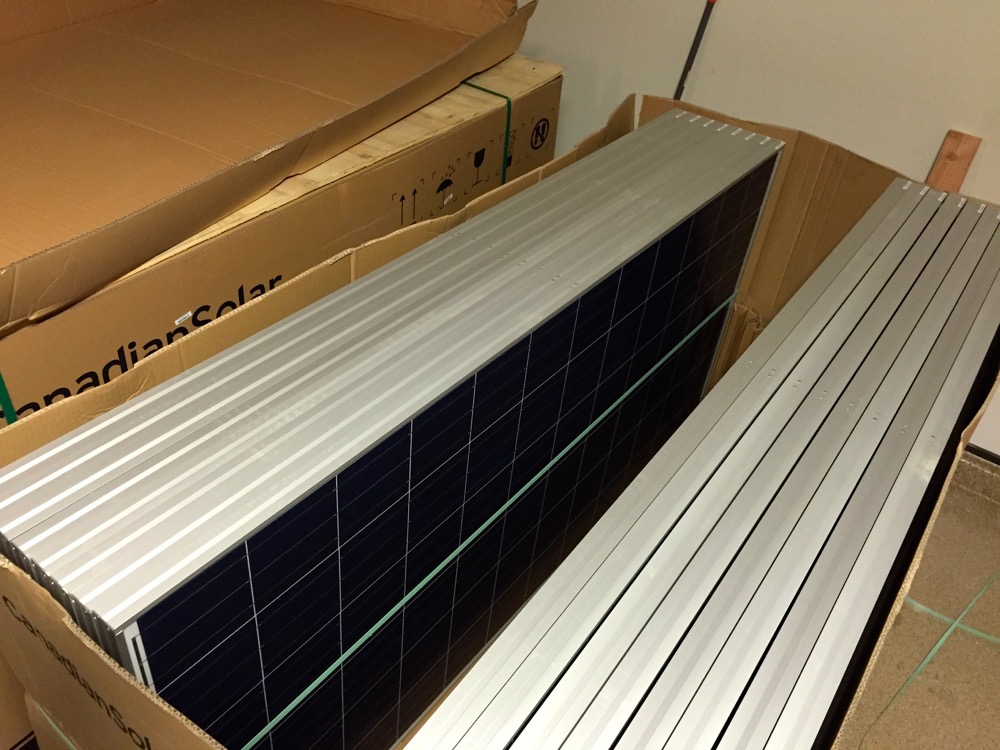

                #187
                Be careful when you start taking the panels out of the boxes. When I got maybe 2/3 of the panels out of my box, I realized that the only thing keeping the remaining panels from tipping the box over was the sides of the box, which are held in position by the bottom of the box, which is held in position by the weight of the panels on the other side that weren't there anymore
                It looks like you may have figured that out and are removing them from the center first. I think you're smarter than I am.
                • HX_Guy
                  • 1002
                  #188
                  Haha no, that's how the box came...there's only 16 in there so they removed 8 from the warehouse, the other box is a full set of 24.
                  I would of liked it better if they were stacked like pancakes, would definitely make it easier to carry them to the backyard with two people I would think.
                  • HX_Guy
                    • 1002
                    #189
                    Looks like these were packed pretty intelligently, there's a half box left over after you remove the outer box and then each panel is slotted into place.
                    I also finally figured out the dilemma with the holes in the tile...was going to use a grinder with a diamond wheel but was was taking kind of long (having to make 4 cuts) and wasn't a very clean cut. Tried out a diamond tip hole saw and works great, though I need to order a bigger one off Amazon, Home Depot only had a 2" and it's too small to drop down over the cone all the way.
