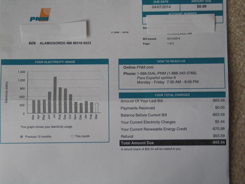

                            I've had solar power for 4 years. My first month was a partial, and I think the bill was $30. Every month after that my bill has been zero. PNM here in New Mexico applies my REC money against the bill, including all the connection charges, fees, tax whatever. The monthly check I get from them for the surplus is usually $60-80. I kinda like having a zero electrical bill...but the monthly check is icing on the cake. By time AC starts June 1st, I should have 1200KW in the bank.
                            So can solar power zero out your bill..? As previously mentioned all states are different. Here in NM, yes. Upper right hand corner there's the zero......the number hi-lighted in black is what is due me. $65.54 this month.

                              #44
