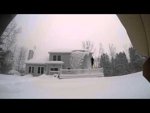

    The other thing to note is if you can access the panels with a rake, if its raked right after a storm, the snow is no where near as dangerous as if the you wait a few days or let it just slide on its own.
    • Mb190e
      • May 2014
      • 167
      Yeah I'm worried about it falling on the dogs and the kids. So I take a proactive approach and try to get it off of there before it slides off unexpectedly on its own. Plus the quicker I get it off the more power I can make. Last thing I want to do is trap it up on the roof.

        Nice video with good production values.
        I like the way raking a small section can trigger a large wide area slide. If you had projections that increased surface friction that would not have been nearly as dramatic.
        Are you speculating at the end that if you had not snow blown the deck the top section would not have slid so soon?
          No, we were forecasted to get 2 feet of snow I had the camera out there rolling all day waiting for it to slide off. I was recharging the battery on the camera when the rest of it slid down.
