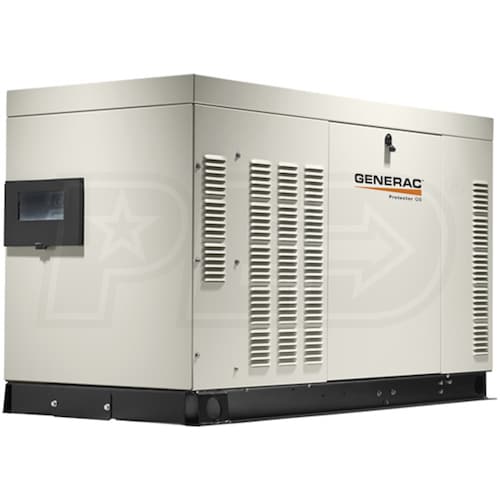

        Assuming all of your cooking is natural gas or propane, main electrical usage should be primarily HVAC & Walk-ins, correct? On Sunny days what percentage of consumption is your 11kW array after to offset? Commercial HVAC and chillers / freezers use a lot of power. Is the climate such that you can operation without HVAC? Will customers be comfortable?
        In general, though, I agree with @bcroe I would seriously consider a nice 1800 RPM liquid cooled natural gas generator instead. Likely much cheaper on the CapEx front. But, on the OpEx size, burning that much natural gas gets expensive after a day or two.
        Like this one for $11K
        The Generac Protector® QS Series 27kW Automatic Standby Generator w/ Mobile Link™ (120/208V 3-Phase) RG02724GNAX has been discontinued. Check out Expert's recommended alternatives for another top standby generators liquid-cooled generator.
        Fully installed (pad, gas line, meter, ATS, permits?) you're probably looking at $~$18K-$20K.

              Unless you have a lot of space to scale up your PV field and a lot of money for high density energy storage, the only two options are to shutdown or invest in a genny, Of course, investing in a generator is only helpful IFF you can continue to process transactions (POS), take reservations (phone/online), get grocery deliveries, and have customers in the area who want to and think to come to a black out zone for dinner.
              Actually, thanks to Fracking, running the genny is cheaper than ever. For the one I referenced:
              197 ft³/hr @ 50% load (~12.5kW)
              197 ft3 / 96.7 ft3/therm = therms 2.037 therms / hr (@ 50% load)
              at $1.323 / therm
              $2.694951 / hr
              $64.68 / day -- that's a fantastic price actually -- seems too good to be true. That's probably less than your electric bill.
