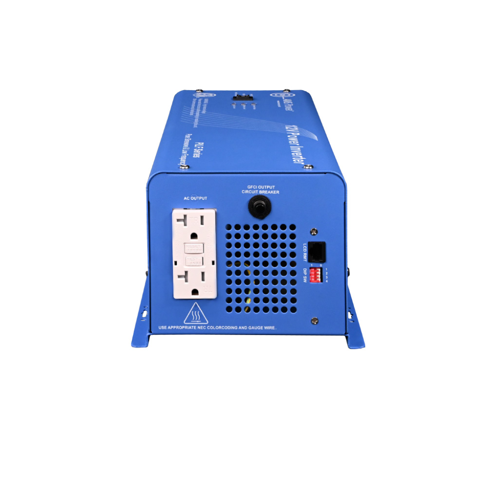

                To add a couple more words. If you are running a Fridge, you should use a Pure Sine Wave inverter. They cost more, but less than replacing the Fridge. A motor running on a mod sine inverter, consumes about 20% more power and therefor, 20% hotter. In a fridge, the motor is sealed inside the compressor, and so the fridge has to run 20% longer to dump the extra heat. And if the motor is too hot, it dies, and you replace the fridge.
                Charging a cell phone, a couple LED lights, consume next to nothing, if you are already running a fridge.. Expect to replace a pair of 6v golf cart batteries every year, since you will be subjecting them to heavy usage.
                And you must have direct strong sunlight for the panels to work and charge the batteries,
                Which inverter do you recommend?

                  Pick a name brand Pure Sine Wave Inverter
                  http://www.aimscorp.net/12-Volt-Pure-Sine-Inverters/

                    Get reliable power wherever you need it with high-quality, high-performance AIMS Power 12-volt pure sine power inverters from The Inverter Store.
                      Here's another one avaib in 600w and 1000w + http://www.samlexamerica.com/product...l.aspx?pid=109 (thanks to Sunking for the link to that one)
                        You are welcome.
                        Here is another one I have specified in about 300 Cell Tower sites from Exeltech . They now make 12 volt models from 125 watts up to 2000 watts. They are hot swappable and redundant N+1. They are rack mount optional with redundancy. As more power is demanded the next unit comes on line. Example if you needed say 1000 watts, you would use 5 x 250 watt modules. If all you demand is 200 watts, only one unit is on line. The 5th one is N+1 redundancy.
                        But you can also just use a single 1000 watt unit. They are made for 100% duty cycle and 25 year MTBF. What is unique about the Exeltech no other Inverter can do is supply extremely poor PF loads like a bank of rectifiers or servers all of which are non linear loads even generators have trouble with. Motors and electronics are a piece of cake.
                        Samlex also makes a Professional 100% Duty cycle line in their PST line up. Those can also handle poor PF loads.
