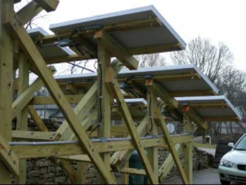

                Interesting the claim that Enphase have a life of 300 years - that is someone misreading data
                He claims he got the 30% tax credit on homemade panels?
                All in all, a typical youtube presentation - lots of claims and fluff but not much more - the one on heat pumps about turning an ASHP into a GSHP is a bit silly.
                The internet is a blessing and a curse - in the old days the BSers could only get to their neighbors wo knew them to be what they are - now they can go world wide.
                  Without looking at the documentation I can't say he's BS or Not. Guess the only way to verify is to get a copy of the approved permits and plans he submitted. As for the 30% tax credit i don't recall any provision that the panels had to be manufactured (not a tax expert) just that they can claim the credit when the system is put into service. Since the video claims they had planning approval and the utility allowed it i would suspect that the Tax authority wouldn't balk. Could be that they just claimed the credit and they didn't get rejected or audited.
                  The 300 year is a claim made by the company itself
                  From the "Reliability of Enphase microinverters" literature

                    The 300 year MTBF does not mean a 300 year life.

                        The 300 years is misleading for sure - but not inaccurate as Enphase uses it.
                        The ASHP to GSHP conversion talked about - he was apparently converting the unit to a DX type where the refrigerant goes through the buried tubing. The concept is identical to commercial units however commercial units are designed and equipment sized for that use. The conversion would be a hodge podge mess.
                          Ray you live in CA where electrical and building codes are the strictest in the country. No AHJ is going to issue you a permit with DIY panels or materials. You might be able to pull a permit to do the install yourself, depends on how tight of a grip the trade unions have around your local government throat, but none will issue a permit with DIY panels. California local NFPA is already looking very close at solar and getting ready to slam the industry with strict new local codes. There have been a rash of fires in southern CA with Solar systems and FD are throwing a fit and have a loud voice in the NFPA, they run it along with insurance carriers.
