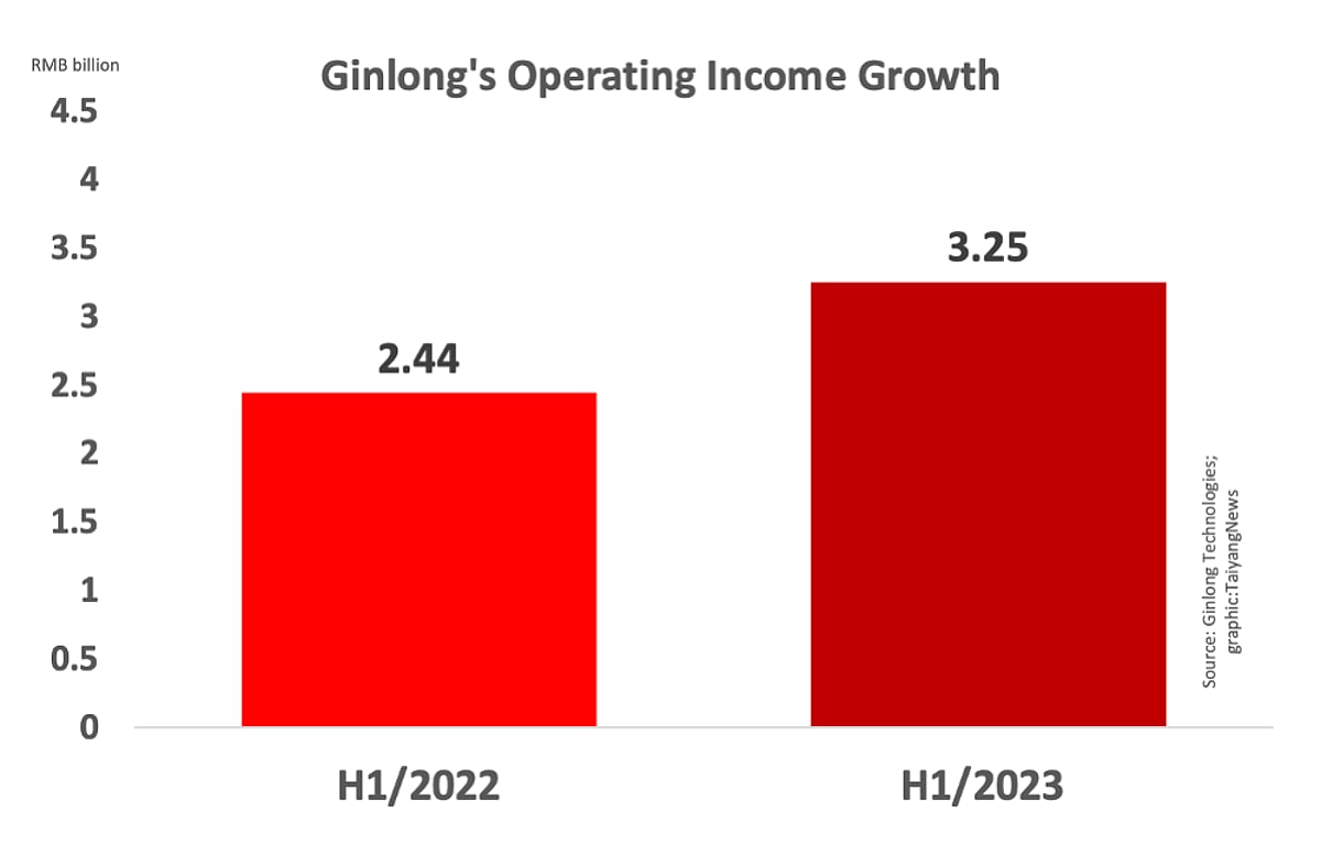

                              Wholesale panel prices in Canada are down to 36c/W. European wholesale prices are even lower, at around 77 Euros for 425W panels.
                              I expect the price drops to level off by next summer.
                              Inverter prices are still high, with 7.6 Growatt or Solis string inverters selling for about C$1400. With the semiconductor shortage over and significant capacity expansions ongoing, I expect inverter prices to drop by 20-30% over the next year.
                              Ginlong's solar inverter business accounted for 68.56% of the group's total operating income in H1/2023   Household PV power generation system and energy stor

                                #45
                                https://taiyangnews.info/a-healthy-h...nverter-maker/
                                Great so hardware prices in Canada and Europe are coming down but here in the US I still think they are high and not good for the lower income society.
