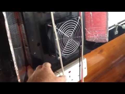

                        Hello,
                        As I live off-grid, and I have had this same dilemma of air conditioning (I am in sub-tropical climates). I have taken the bull by the horns, and have been exploring the "Peltier" technology. I have been getting some great results by falling on my face and learning form mistakes... But it is paying off in the end.
                        Here is the first unit I had made...
                        I am quite happy with the first test !!!
                        Alan

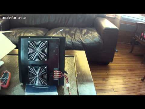

                          #147
                          Hello,
                          I then had to think about the larger rooms !!! So me and a few friends did the math, and designed a big unit...
                          Could be a good the answer !!!
                          Alan

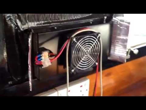

                            #148
                            Hello,
                            Now that I have the machines, It is time to do some testing... The smaller unit first !
                            I am pleased !
                            Alan

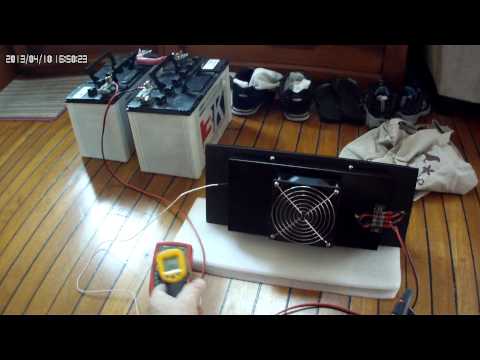

                              #149
                              Hello,
                              The results are fantastic, so time to test the big unit !
                              One step forward !
                              Alan

                                #150
                                Hello Again,
                                Now this is the latest test that same afternoon...
                                Overall... we can get Air Conditioning without AC power... we just need to think outside the box and do it for ourself !!! I am quite sure no oil company is going to support us !!!!
