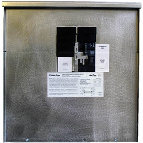

                Feel free to move this to a new thread if that would make more sense.
                For those of us looking to implement a new transformer (auto or otherwise) to phase balance 120V and 240V loads across a 240V split phase genny output (Generac XP6500E) is there a preferred product?
                AC Rated Output Running Watts 6500
                AC Maximum Output Starting Watts 8125
                Rated AC Voltage 120/240 VAC
                Rated AC Frequency 60 Hz
                Rated 120/240 VAC Amperage 54.2/27.0
                Max 120/240 VAC Amperage 67.7/33.9
                Many folks seem to like the Outback PSX-240 (Autoformer with Housing and fan)
                But I was thinking that this Victron might be as good or better
                Use the Autotransformers for step up, step down and split phase output balancing purposes. Find a Victron Energy dealer near you.
                Any thoughts? ChrisOlson, I know you and your neighbor have the Outback.
                I'm not looking to build something custom. But wiring up cords, etc. as needed is not a problem.
                Currently using extension cords when the power goes out. Hoping to step up to a manual transfer switch at some point like this one:
                Generac-6335
                Buy Generac 6335 Direct. Check the Generac 6335 - 200-Amp Outdoor Power Center (50-Amp Generator) ratings before checking out.
                Obviously cannot run my AC on such a small genny, but want to eliminate the trip and fire hazard of using extension cords and use my existing load center.
                This is just for "emergency" use during prolonged power outages. We lost power for 10 days from hurricane Sandy.
                The generator itself if a gas guzzler and rather load, but it runs like tank. Had some initial issues using it because I was unfortunate enough to get the "new OSHA model" which has GFCI on the 240 outlet.
                -Jonathan
