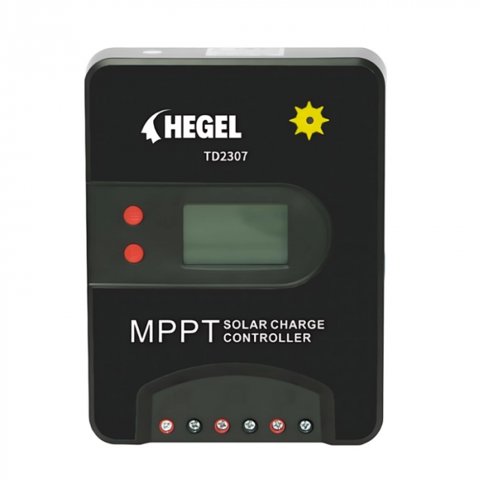

                      Good morning from cold Nebraska everyone, yea it’s still cold here. I have been on solar now for more then ten days. Most days with sun the panels charge up the batteries decently, however on cloudy days my LVC lights and alarms do go off.
                      I noticed I’m getting 9-10 watts from the panel “array” even with full sun, yet I have a 320 watt and a 100 watt up there? Am I missing something, shouldn’t my input into the MPPT be far more even with calculated loss factors?
                      photo attached, I hope lol

                        When I look at your controller, it looks like a PWM controller. A lot of those are marketed with a dishonest "MPPT" label with the loophole it is the MPPT model #, not intended to confuse anyone with a MPPT. Its in the small print, did you see it? I don't know why you're only getting 9 watts off the roof. It could be because the battery indicator (68%) is not accurate and you've actually went from bulk mode to absorption mode to float. In float mode after the battery is charged, it may very well be pushing 9 watts.

                          #102
                          Hey there, that is both cryptic and helpful!
                          as for the controller not being what it is supposed to be, I’m not sure but I can assure you almost certainly that the batteries are nowhere near charged lol, they NEVER charge
                          as you know I have taken some course and education in solar since I was in Mexico, what would be a good first step in identifying the issue. I have my ohm meter handy. Also could this be the result of the “mystery panel” , what SHOULD be coming off that panel.
                          I’ll start with the batteries in a bit and report back a volt reading and we can go from there. My thoughts is the volts should add up to what is being said on the MPPT SCC, again though I think that readout is “instant” verse cumulative, like when I turn on my on demand pump to flush the toilet and the battery “level” drops 20%
                          lets start to really get hands on, if you guys will guide me I’m confident we can figure the system out and build it better, for now I just want the max it can give!

                            #103
                            Update: located the manual finally at the following link, I went through every setting step by step, found some interesting things, this does appear to be a true MPPT controller, however I’ll let you look it over.
                            I noticed my power generation per a given day is less then my power consumption, which is not all that surprising, but needless to say I’m more curious why my charging current is only 0.78 amps!

                              #104
                              OK I’m updating this with some new information I went on top of the roof it’s approximately 1715 so the sun is definitely on the panels but probably not at its peak right now I disconnected the baby panel also known as the “helper“ panel 100 W and then just ran the Solar down to the MPPT controller on the main Trina 320 W panel, I saw between 15 and 20 V but again the fluctuation between the nine and 10 A continued I then disconnected the main panel and only hooked up the “helper“ panel I noticed the 9 to 10 amp fluctuation as usual however I did notice the voltage was not as high as the main panel operating somewhere around 13 to 17 V again I don’t know what this proves if anything but so far that’s what I’ve done. My sincere hope is that someone on this form steps and that’s done the stuff before and starts talking to me so we can run some significant tests we have really bad weather moving in here in the next couple days so my window to do so I was running out.
                              One final thing I noticed on the train at 320 W panel there is three solar modules connectors only two of them are being used my guess is it would be for a different voltage shut up that I would use the other panel connector, to clarify what I’m speaking of underneath the panel there are three black boxes one of them has the positive cable going to the NPPT controller the other one has the negative cable I don’t know what the one in the middle is it’s not hooked up to anything with any wires coming from it.
                              that’s most likely all the tests I’ll be able to run today but tomorrow I have one more day of good weather if there’s any certain tests or diagnostics anybody can think of I should run so we can figure out why I’m only getting 9 A and 17 to 20 V off about three 420 watt setup.
                              finally, keep in mind while I know a lot more about Solar than I used to I don’t profess to be a genius I will rely heavily on what you guys can tell me and then I will go ahead and implement what you tell me so we can learn together.
