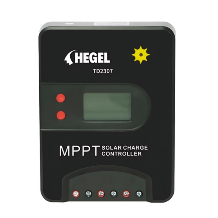

    CFC192F2-D2C9-45AB-92C6-AAFC51E2EA79.jpegSo I guess the panel is not supposed to be giving 9-10 amps, so at least that part is normal, I would like to know how many “watts” it’s giving back, unless watt-volt/amp happens at the panel and in that case volts/amps is all we will see on the MPPT
  • The_realTW
    replied
    OK I’m updating this with some new information I went on top of the roof it’s approximately 1715 so the sun is definitely on the panels but probably not at its peak right now I disconnected the baby panel also known as the “helper“ panel 100 W and then just ran the Solar down to the MPPT controller on the main Trina 320 W panel, I saw between 15 and 20 V but again the fluctuation between the nine and 10 A continued I then disconnected the main panel and only hooked up the “helper“ panel I noticed the 9 to 10 amp fluctuation as usual however I did notice the voltage was not as high as the main panel operating somewhere around 13 to 17 V again I don’t know what this proves if anything but so far that’s what I’ve done. My sincere hope is that someone on this form steps and that’s done the stuff before and starts talking to me so we can run some significant tests we have really bad weather moving in here in the next couple days so my window to do so I was running out.
    One final thing I noticed on the train at 320 W panel there is three solar modules connectors only two of them are being used my guess is it would be for a different voltage shut up that I would use the other panel connector, to clarify what I’m speaking of underneath the panel there are three black boxes one of them has the positive cable going to the NPPT controller the other one has the negative cable I don’t know what the one in the middle is it’s not hooked up to anything with any wires coming from it.
    that’s most likely all the tests I’ll be able to run today but tomorrow I have one more day of good weather if there’s any certain tests or diagnostics anybody can think of I should run so we can figure out why I’m only getting 9 A and 17 to 20 V off about three 420 watt setup.
    finally, keep in mind while I know a lot more about Solar than I used to I don’t profess to be a genius I will rely heavily on what you guys can tell me and then I will go ahead and implement what you tell me so we can learn together.
    Tonight I’m also going to try to upload those photos again of the complete set up explaining each component component individually I didn’t have luck the past couple weeks and it cooked took me approximately an hour and a half to get them all set up only to find out I couldn’t upload them so I will try again tonight one more time from my laptop.
  • The_realTW
    replied
    Update: located the manual finally at the following link, I went through every setting step by step, found some interesting things, this does appear to be a true MPPT controller, however I’ll let you look it over.
    I noticed my power generation per a given day is less then my power consumption, which is not all that surprising, but needless to say I’m more curious why my charging current is only 0.78 amps!
    the mystery continues....
