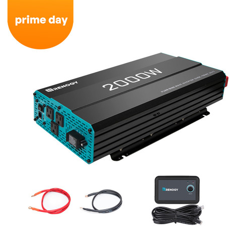

                      The problem is I can't spend more money than I have in the bank, so a lot of this is 100% impossible. The stuff I have now was all relatively inexpensive. I am putting my batteries in parallel now because my inverters are 12V. The inverters I want are out of my price range.
                      The Renogy I am looking at is also 12V:
                      Renogy 2000W Inverter transforms the DC electricity stored in batteries into standard household AC power. Limited time sale, 10% off code: Renogy10off
                      One of my goals was to be able to run AC during a power outage. It looks like I should dump the idea of buying thousands of dollars worth of batteries, that will all have to be replaced in the not too distant future and buy this:
