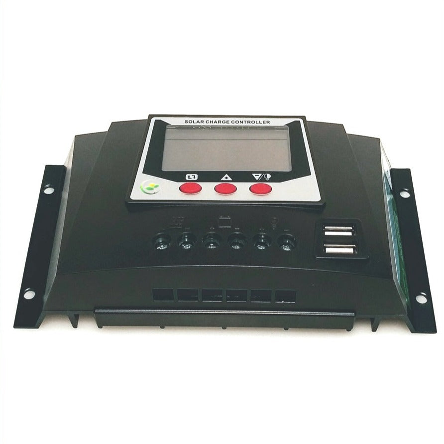

                  You mean something like this?
                  Click here to download the Material Safety Data Sheet for LiFePO4 (Lithium Iron Phosphate) batteries.       Bioenno Power 12V/24V/36V/48V, 30A Solar Charge Controller (Model SC-4830JUD) is a versatile controller for use in solar systems with an integrated LCD display, that is designed to charge LiFePO4 (Lithium Iron Ph
                  And then using 36V panels since this regulator can't boost voltage. This would minimize conversion losses too of course. I'm just worried that the ebike battery might take damage when charged in this manner, but maybe I worry too much?

                            That looks like a solution, except its 30A and with a 100W 50V panel you only need 3A or so. The
                            small panel is going to limit the possible charge current. Bruce Roe
                              Can you buy a spare battery for the bike and use a high end charge controller like a morningstar, that is programmable for 36V, and use a couple panels in series, to charge the battery directly? You will have to get battery specs, and be able to use a computer to program custom setpoints.
                              The TS-MPPT-30 https://www.morningstarcorp.com/products/tristar-mppt/ could do that, as could the Midnight Kid http://www.midnitesolar.com/products...lers%20-%20KID
