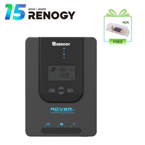

      The current controller is a Renogy 40 Amp MPPT
      Buy Renogy's Rover 40 Amp MPPT Solar Charge Controller. Pair it with our BT-1 the BT app through bluetooth and you can monitor and adjust your solar system directly from your phone. Our Rover also comes covered in a die-cast aluminum exterior. This allows for safe heat dissipation along with protection from normal wear and tear. Shop for yours now.
      We had mayor trouble in the beginning and it turned out to be a faulty controller witch they replaced. Perhaps it was bad from the beginning. I assumed that the parallel charging damaged it.
