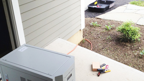

                            On Sunday morning June 30th, we experienced our first prolonged power outage since moving in to our new passive house in Connecticut. A tree came down on one of the power lines around the corner and power was out for about six hours. It was time to see our inverter in action — the inverter that we bought from Converdant Vehicles to turn our Prius into a backup generator.
                            I bought my inverter (a large UPS) 3 years ago specifically because it could run from the Prius' traction battery, but I ended up buying FLA's instead and never hooked it up to my wife's Prius.
                            If you can manage the wiring connections safely, and have sized inverter to your loads and transfer switch,
                            it's a pretty decent system. As efficient as the Honda inverter gensets on auto-throttle, the Prius uses a
                            high efficiency alternator for the traction battery, not the 80W 12v aluminum brick on most cars.
                            But it's not seamless, you still have to manually move the car out of the garage and hook up the cable AND leave it "ON" and unattended in the driveway (I don't know if you can lock the door from the outside with system enabled)
                              On 2005 models anyway, you have to lock the driver's door with the mechanical key. Otherwise neither the electronic fob nor the handle switch nor the armrest lock button will actually lock all the doors if the key is detected to be inside the car and possibly if the drive system is turned on.
                              I am not certain that the drive system being on makes a difference, so you might be able to just lock it with the engine enabled as long as you took the key with you.
                              To run a Prius through a car wash, you pretty much have to be inside the car to avoid the park function from being enabled.
                              If you do not put the car in Park the hybrid drive cannot use the engine to charge the batteries. If you switch to neutral to stop for more than a few seconds, a warning will appear on the screen telling you that the traction battery will not be charged.
