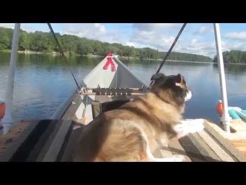

    Solar Wings Serenity Canoe
    I did some testing on the lake the other day with full sun this time. The new slide out wings worked out really nice. I liked my original design and with the slide outs I was able to add 200 watts more to my system without taking up space in the canoe. Have a look at a few more pictures and a short video cruising on a local lake.
    As always feed back and new ideas are most welcome
    Tommy
    Short video: https://www.youtube.com/watch?v=neXoylRmvwQ
