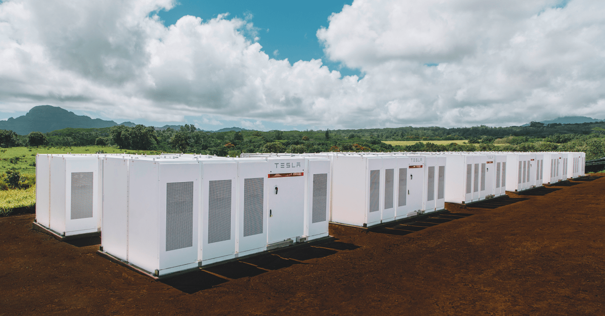

If a Power Wall 2 is not big enough for you ?
  • NEOH
    • Nov 2010
    • 478
    If a Power Wall 2 is not big enough, then get a Power Pack 2 ...
    http://www.businessinsider.com/tesla...ck-batteries-6
    210,000 Watt-Hours per Power Pack 2
    Used to offset peak-power , with or without a Solar PV Array, as needed
    Helping Puerto Rico ...

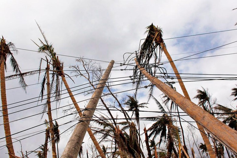

      Currently 265 linemen have been on-the-ground, some for the past 30 days, replacing / repairing the electric power poles, as quickly as possible
      Power is returning to the island, as fast as they can install new power poles and pull new wire.
      Soon there will be 1,000 workers, repairing the 2,500 miles of power lines.
      The Power Wall and the Power Pack will help make the power more reliable - reduce the effects caused by rolling blackouts.
      Progress is quietly being made, daily.
      Newest estimate ... 95% restoration by Dec 31st - just two more months.

        Would a PV Array had survived any better or worse than old Power Poles and Transmission Lines?
        Certainly, local generators would be great idea for temporary de-centralized AC Power, after a hurricane.
        Obviously, there was no disaster planning - they could not even maintain what they had.
        Would a PV Array ( roof or ground mount ) have survived this hurricane (assuming the building survived) ?

                      OK, it appears that Puerto Rico's Island-Wide electrical grid will be Decentralization ...
                      Delivering power to the inhabitants of a small island is a very different challenge to the sort found in other places. Resource poverty can mean that vital supplies need to be brought in, either by air or sea, purchased at a premium. The environment often offers its own bundle of problems, including the fact that the prevalence of salt water often corrodes mechanical equipment. Fast-growing vegetation and rocky terrain can compound the issue, making power networks hard to build and maintain.
                      If Elon Musk has his way ...
                      Tesla will be installing Micro-Grids comprised of Solar Panels & Tesla Power Packs.
                      Will Tesla replace your fragile PV Array, if there is another Hurricane?
                      A 21st Century Grid ( whatever that means ) ?
                      This is a huge problem ...
                      "... these [power] lines often run through high mountain regions where access by road is either poor or nonexistent ..."
