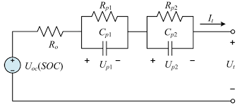

                A typical condescending reply with many factual errors. I should have been clearer, I was interested to know how the term Absorb came about, not what the process is.
                Now to the glaring factual errors. The internal resistance of a battery or to be more correct the internal impedance, but lets keep it simple and stick to resistance is dependent on many factors some physical and some chemical. The simple physical factors that you are talking about are the bulk resistance of the conductors and the active materials in the battery and as you say are covered by Ohm's law and don't change much. They are only part of the total resistance, the resistance caused by the many chemical processes is variable and difficult to calculate. See powerstream.com/internal-resistance.htm or en.wikipedia.org/wiki/Internal_resistance for more details. The chemical processes are a large factor with lead acid batteries that limit extended large charge and discharge currents and result in the need for long absorb times.
                Your statement "Makes no difference if charge is stored by moving Ions in an LFP battery or electrons in a Pb battery. Again it is Ohm's Law, not chemistry" just shows that you do not understand battery chemistry and how it impacts on the electrical characteristics of batteries. For starters, both LFP batteries and PB batteries have ions moving from the anode and cathode to and through the electrolyte and electrons moving from the anode and cathode through the external circuit to balance out the flow of ions. The chemical difference between the two battery types is that in LFP batteries lithium ions move from the electrodes into the electrolyte then move through the electrolyte to the opposite electrode and electrons moves through the circuit. With LA batteries a chemical reaction occurs at the electrodes which releases or consumes hydrogen ions, sulphate ions and water from the electrolyte.
                As you increase the charge rate say from C/20 to C/10 you arrive at Absorb at 70% SOC and now will take a much longer time to saturate, You hit a wall with LFP at C/2 charge rate and you arrive at absorb at 50% SOC, and will now have a 2-hour Absorb time. At 1C it will take you 3 hours from fully discharged to fully charged. Is that because of the chemistry? No Sir. Its Ohm's Law because Pb has the same speed limits regulated by the INTERNAL RESISTANCE.
                Where do you get your data? These two graphs are from charge tests I did on a four year old Winston LFP cell. Nothing like what you say.
                No technically it is called Constant Power, which is limited by the flaky and unreliable source of power; the sun and clouds. But it is still referred to as CC because the circuit is identical in operation. A Solar CC will deliver as much current as the variable Power can provide up to CURRENT LIMIT. AC chargers do not have this problem as power is unlimited with no time constraint. If you replaced your Solar Panel with a 18 volt DC Power supply, the Controller would work exactly like an AC charger as I described above.
                Power = Voltage x Current, how can you have constant power if the current is variable when charging from solar?
                For LFP batteries, charging from solar is not the same as charging from a constant current charger. With a constant current charger we can charge at say ~C/4 (0.25C) and terminate the charge at 3.45 volts and have a predictable ~90%SOC. With solar we could have anything from ~90%SOC to ~99%SOC due to the variable nature of the power coming from the solar panels. If you are bottom balancing with no BMS this could have disastrous consequences.

                  #158
                  Karrak you are proving you really do not get it. First Impedance has nothing to do with the discussion. it is pure DC resistance. That is just a diversion tactic you are trying to use. Impedance is used as a measurement for baseline reference for battery health, and modeling how a battery is going to perform on digital loads. DC resistance cannot be used on working systems without interruption in service, impedance can be used at any time.
                        If you want to reduce this more accurate simplified battery model to this less accurate one
                        that is fine by me.

                        I agree with you that the current going into the battery is dependent on the resistance of the battery, problem is that a portion of the resistance of the battery is caused by the chemical processes that are going on inside the battery. I am fairly sure that this resistance if nearly constant over the whole charging range of LFP batteries which gives the nice flat curve. It is not the case for LA batteries.
                        Are you really that stupid and cannot grasp Ohm's Law? Yes P = IE, which means I = P/E. In the charging process on solar P changes with sun conditions, and thus varies unlike a stiff source with unlimited Power of the grid and commercial AC charger. If Power Input changes, so does charge current. As power goes up, current follows, as power goes down, current follows. Very simple 5th grade math. So technically a Solar Charger is Constant Power in Stag 1, butz the circuitry is a Constant Current Source. It will convert all available power into current up to the point of the chargers current limit rating. It is not hard to get your brain wrapped around if you understand basic principals of Ohms Law, current and voltage sources. Apparently they do not teach that where you live.
                        Are you just trying to baffle everyone with this drivel. How can power go up and down and still be constant? sounds like newspeak to me. When I went to University a Constant Current Source was an idealised device that provides a constant current into a load (in this case a battery) regardless of the voltage across the load. I have even designed circuits with constant current sources in them. Surely a Constant Power Source provides constant power into a load regardless of the voltage across the load and current going into the load.
