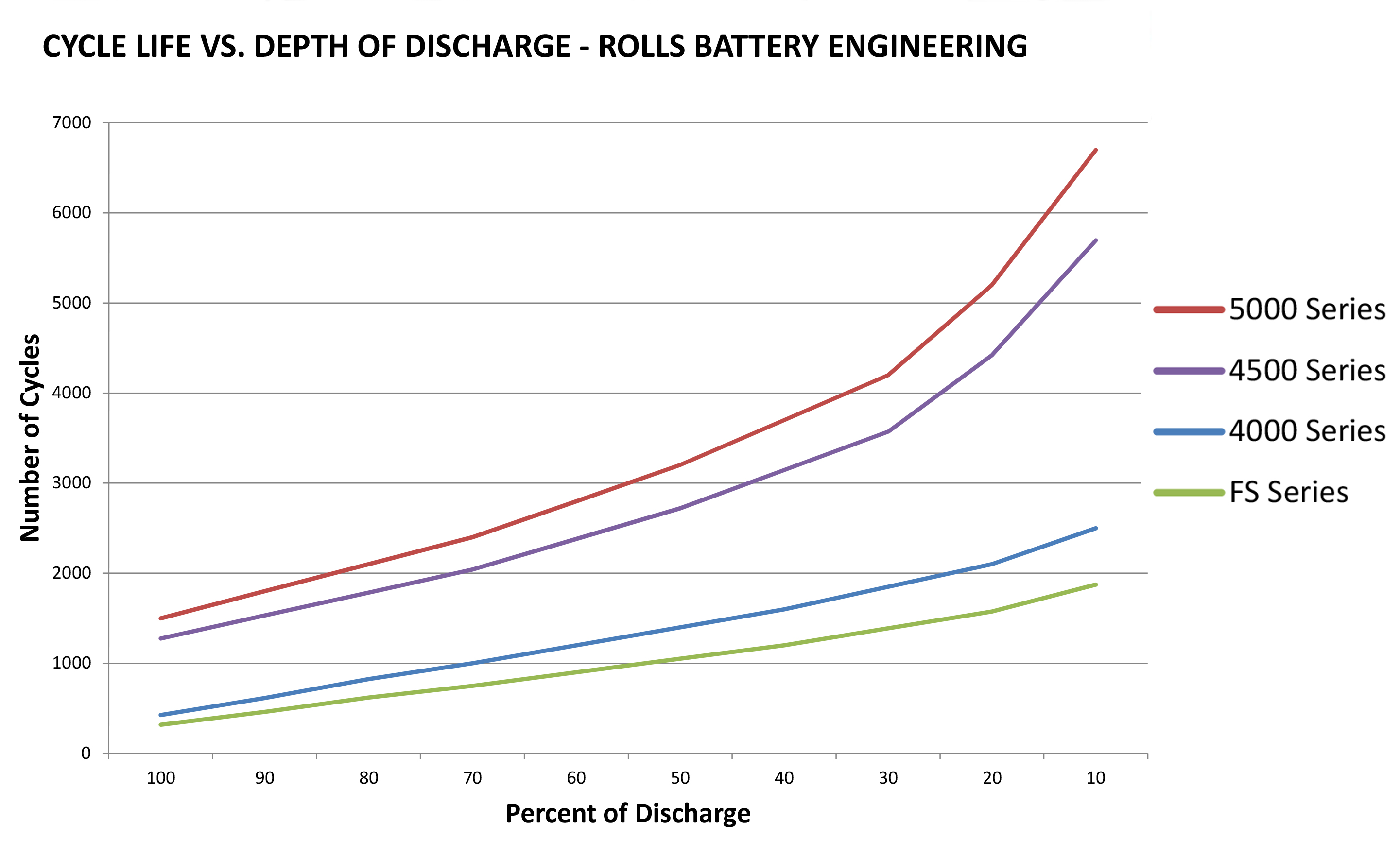

                        #116
                        LiFePO4 in all specs I seen are tests at either 100% DOD or 80% DOD (from 100% SOC down to 20% SOC) and they last min 2000 and up to 3000 cycles depending on manufacturer and quality of the cell.
                        OK that is what happens when you are a 1 Trick Pony.
                        Rolls Battery 1500 cycles with 5000 series at 100% DOD. At 50% DOD greater than 3000 cycles. Over 5000 cyles @ the designed 20% DOD. With LFP you have a Boat Anchor @ 100% DOD and around 2000 between the sheets. Rolls Kwh 5000 series cost are 1/3 to 1/5 of all LFP.................... You do not have to be an engineer or accountant to understand facts.
                        Any questions?
                              Rolls Battery 1500 cycles with 5000 series at 100% DOD. At 50% DOD greater than 3000 cycles. Over 5000 cyles @ the dsigned 20% DOD. With LFP you have a Boat Anchor @ 100% DOD and around 2000 between the sheets. Rolls Kwh 5000 series cost are 1/3 to 1/5 of all LFP....................
                              Any questions?
                              Me thinks I am done here. How about you?
                              Of course that premium Trojan battery was not the best battery in the market but what I calculated was cost / kWh stored.
                              So let see how much better is this Rolls 5000 series I have no idea but I will calculate just now.
                              I found this 6-CS-25PS from the 5000 series at 1235$ seems to be the best price (some say retail is over 2000$ but that is advertising I think)
                              This has 681Ah at C 1/10 so using the same formula from my table 6x681Ah = 4086Wh x 1500 cycles 100% DOD = 6129kWh then 1235$/6129kWh = 20cent/kWh I think that is almost the same as Trojan premium or quite close is like they make the reverse calculation when they set the price for this batteries.
                              Anyway is not a better value for money that the Trojan Premium and is probably worse since you will need to use this at higher rate to be able to make use of the entire capacity over the 10 - 15 years amortisation period.
                              You will need to discharge this in average to 50% every day to get the benefit of higher cycles over 10 years amortisation and if you discharge this at high rate you will have way less capacity is not as LiFePO4 where 1C discharge is vs C 1/10 makes no difference.
