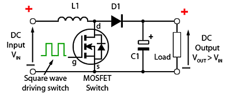

            Sunking, if an input voltage in the range presented in my scenario were causing the BMS to disconnect due to over voltage, then wouldn't this prevent the battery from ever being charged? I always connected the panel to the controller first in full sunlight, so the BMS always encountered open panel voltage when the partially discharged battery was first connected--granted, at 0A.
            Is it possible that the controller misinterpreted the battery's drop in current when it switched from CC to CV as a disconnect? If, on the other hand, the BMS did disconnect the battery when fully charged, shouldn't the controller handle it more gracefully? Or is it possible that this is the only battery that behaves this way?
            The battery mfr. states that the BMS expects a CV voltage of around 14V (I've asked for an exact value), and the controller mfr. states that the controller's CV voltage is 14.2V. Would you still suggest changing the controller's voltage?
            Not sure if this adds any value, but the generic CC/CV AC charger that came with the battery handles the transition from CC to CV with no problem.

                        You read 18 volts on both ports?
                        No LFP battery would survive that, it would explode into flames before it ever reached 18 volts. Something is not right. Only way that can happen is if the battery disconnected on a Genasun controller. .
                        Something no one has caught yet, but Genasun is the only controller on the narket that requires the panel be connected before the battery. Do that to any other controller and it will let the magic smoke out. When you connected the panel first, what did you observe?
                        I bet the voltage went high and in alarm? Then when you connected the battery went normal, charged,, then went back into alarm when the battery was charged? Is that what happens?

                          I would think that the BMS will only disconnect the battery when the voltage on any of the individual cells goes out of its safe operating range, probably something like 2.5 to 3.65 volts. If the battery is balanced and the cells all have the same capacity this will equate to an overall battery voltage of 10 to 14.6 volts.which is what their documentation implies. They specify a charge voltage of 14.6 volts.
                          When you are charging an LFP battery to start with the battery will take as much current as the charge controller can give it within its specified limits. If you are charging from solar this is as much current as the solar panel can supply and varies depending on the amount of sunlight. With other power supplies this is usually a fixed current and is known as CC. The battery voltage will rise as you charge. When the battery reaches the cutoff voltage the charge controller will start to limit the current going into the battery to keep the battery voltage at the cutoff voltage. This is known as CV charging. With an LFP battery the charge current will taper off to zero.
                          For lithium batteries the charge controller should never let its output voltage go above the programmed cutoff voltage!
                          What I think is happening with the Genasun is that it will not let the current drop to zero, because of this the output voltage will continue to rise until the BMS in the battery does its job and detects too high a voltage and disconnects the battery to protect it. It is fortunate the battery had the inbuilt BMS, without it it is very likely that your battery would have been damaged.

                            You need to change your way of thinking because it is the nature of the beast. Every MPPT controller I know of does that. This is due to the fact a solar panel is a Current Source and not a Voltage source. With any Current Source when you open the circuit, voltage goes up to supply voltage immediately. That is just the physics and characteristic of a Current Source
                            This is absolute rubbish. It is the MPPT controllers job to take the output power from the solar panels and convert it to a form that is acceptable and safe for charging a battery. An MPPT controller is basically a buck switched mode power supply and can easily be designed to keep the output voltage below what it is programmed to be. The Genasun is the only MPPT controller that I have heard of that will let its output voltage go above the programmed output voltage. I am sure it is to do with the fact that the Genasun gets it power from the solar panels and not from the battery.

                              Try it and see what happens. Be sure there is bright sun out, and disconnect the battery and see what happens. If you had any clue how Buck Converters work you would know that. Below is the Buck Converter in its simplest form. If the FET looses it reference signal which is what happens if the battery is disconnected, the FET shuts off and the Input is directly connected to the output through L1 and a forward biased diode. .

                                I agree that the BMS disconnected the battery from the controller first, and this caused the the voltage increase and alarm at the controller. I don't think we've been able to figure out why, though. My wild guess at this point is that the BMS didn't like how the controller handled the fully charged battery. Maybe it was something like the controller taking longer than the BMS expected to back down current as the system transitioned from CC to CV? Is that possible? If not, then maybe something similar? Whatever it was, it seems like the BMS gave the controller a few chances to get it right, because the sequence at the end was actually: 1) LED shows "charged" briefly; 2) LED changes to error, and stays there for about 30 sec.; 3) the LED changes from error to charging; 4) repeat steps 1 - 3 for a total of 4 times; 5) the LED remains permanently in error status. Because the number of repeats equaled the number of cells, maybe it had something to do with the internal balancing circuit? A strike against that hypothesis is that there was no such error cycle when the battery was charged using the wall charger or with the Bioenno PWM controller. Once the battery charged, the LED on the wall charger switched from CC to CV and stayed there, and once the status on the PWM controller showed "charged", it remained there. Again, I'm grasping at straws in unfamiliar territory.
                                When you connected the panel first, what did you observe? I bet the voltage went high and in alarm? Then when you connected the battery went normal, charged,, then went back into alarm when the battery was charged? Is that what happens?
                                Yes, that's pretty much what I observed. I've posted this a few times, but in posting again, maybe I'll see something different or word it more accurately. 1) nothing connected to the controller; 2) connect panel to controller --> immediate alarm and high voltage at controller's battery terminals; 3) connect battery to controller --> LED changes immediately from alarm to charging; 4) battery reaches full charge --> first, controller shows charged briefly, then alarm and high battery terminal voltage return. Sure enough, writing out number 4 led to the bulk of my main paragraph above.
                                FYI, I'm in contact with a Genasun user who always connects the battery first.
                                I think a good test would be to get a new GV-5 and a new battery and see if the same thing happens.
