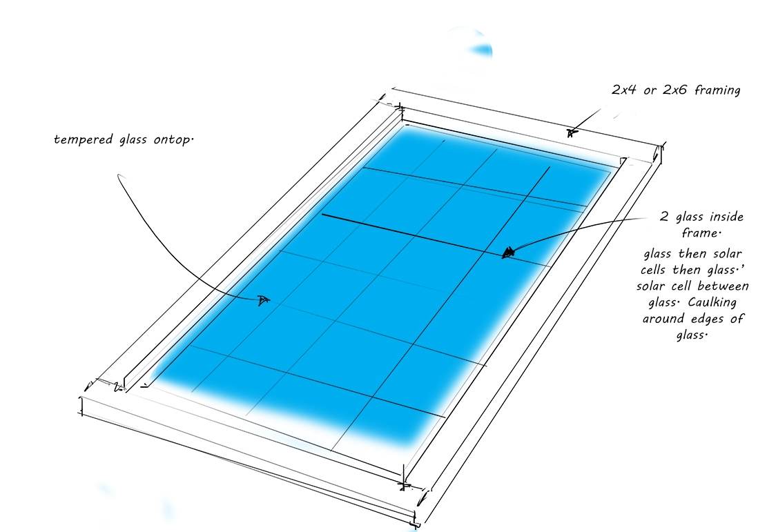

                      I suggest going to a local Glass shop. And Ask if they have "Tempered Glass" Not the solar panel kind. But for DIY that will resist hail for sure. And cheaper I guess. But Depends how thick you get the glass to withstand such hail.
                      And if you want to go the extra mile and test your tempered glass. you could always load a paintball gun with some hard ice. j.k
                      For me Living in Canada. Finding Tempered glass is like- finding a needle in hay stack. It just dont exist.
                      On Ebay the only person I see selling full size low Iron tempered glass is "American Solar Supply".
                      I also suggest a white reflective coating, so when sun hits panel the nice white dosnt heat up cells fast.
                      Despite what you heard about wooden panels. Ive made store front signs with paint. I am a artist. And the most important part about painting wood to make it last and not degrade is lots of varnish and coatings. apply several several layers after each layer dries. And my signs have not degraded in over 10 years not even color.
                      I suggest also paint with white reflective paint several layers also. dry and paint dry and coat. multilayering works best.
                      And then for the inside of the panel itself- I suggest sealing it as best as possible with Caulking gun. seal that sucker up. After one Seal place again another layer and another layer. I say atleast 4 layers. And also do this for the outside seams as well. And also caulking screw holes as well.
                      Also Another thing. Is that there is some -Spray on products I hear you can get that Resists water. And gives the exterior a rubber like surface? Not sure- but sounds kewl.
                      Also use lots and lots of wood glue so it also helps like seal. make sure you cover it evenly and leave no spaces with the glue- even it out perfectly. then apply and screw sucker on. Also you may want to use Very Thick wood. dont cheap out and get thin stuff. The thicker the better. If it were me I wouldnt use anything less than 2x4 for frames. I suppose in Theory the Thicker the wood the less it expands and contracts with weather temp changes. Paint and coat and varnish all your pieces. And even Dip your screws in glue. And maybe do sum reasearch on wood. Perhaps Ceder or Oak would work best.
                      And then me thinks if you wanted to go a step further. To reduce water moisture you can build the frame with the Tempered glass. But perhaps within this setup you have two really thin pieces of glass and encapsulate cells within the two sheets of glass. this will decrease efficency but atleast it will hold up to very little moisture. And then just SEAL SEAL SEAL along the edges of the two thin sheets with your solar cells inbetween those two glass.
                      And Remember SEAL SEAL SEAL dont let any crack go unsealled!
